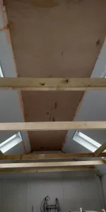

I have insulated between the 6" rafters with 4" kingspan & the floor has 6" kingspan.
Ideally I would have insulated the walls too, however:
1. I really need to maximise the space.
2. The building will be inhabited for approx 4-8hrs/week. When cold, i'd have the heating on anyway. How much would I really save with extra insulation on the walls? But mostly its a space issue- I just don't have it spare. To further mitigate the effects, the sparkie has suggested I install an infrared heater (like the ones on the ceiling in Selco or toolststaion) which apparently warm bodies and not the air as much.
3. Mold needs a source of water/condensate to thrive. After I thoroughly dry the skim, where will that come from if it's only inhabited for short periods of time? What about a paint that I could use to seal the plaster against the ingress of moisture?
4. I can soak up any exceptional humidity using a switched dehumidifier.
5. Trickle vents in the 4 veluxes and doors should maintain good air flow.
In summary, I get the extra space but it costs me a bit more to keep things comfortable.

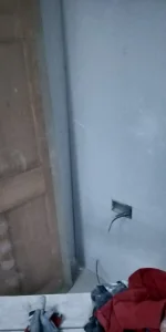

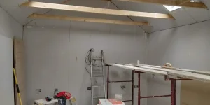

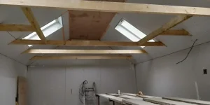

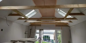

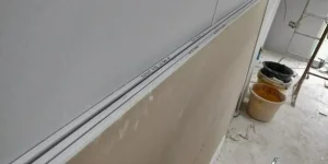

State of play as we speak. 2 days work
3 boards & 6 bags of adhesive left over!

Looks decent enough for 4 days labour tbh. Not sure why they plaster such a small section but that's about the only thing. I personally wouldn't PVA the blocks, not sure why the rest would. No reason the adhesive should dry to quickly unless it's aerated blocks? In which case I just give them a good brush with water prior

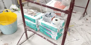

How many bags of adhesive did they use?

4 bags. For about 15 boards...
Yeah I thought it was too few too... Whatever man, I'm gonna trust these fellas know what they're doing- they've been at 60yrs between em. Takin to me about hardwall today and how that was dogs b*ll***s- just can't get it today apparently. And something called carlite??

Oh dear meant to be a bag for every 2 boards.

Wow a bag for 4 boards is ridiculous tbh. Especially as it looks like the boards are flush with the electric boxes so there's a 12.5mm cavity behind the board
