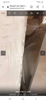

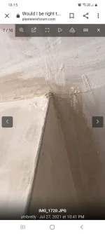

Would I be right to ask for this to be reskimmed?
Thanks all. I've been back again today to check it all and there are a few problems on pretty much all the walls, although some are passable (or seem so, prior to the mist coat). The ceilings also have some minor crazing and all have patches of bumps, which I suspect will show up more with paint? There are lots of minor indents/splotches of plaster which just seems a bit shoddy. The corners generally seem very rough, and the plastering around architraves is pretty uniformly terrible.
Potentially the worst of it is that he damaged one of the ceilings while he was working and said he would replace the plasterboard before he skimmed. Checked it today and he didn't replace the plasterboard, he just skimmed over the crack - and then when the crack showed through the skim he's just PVA'ed it or something?? It's bizarre.
He seems like a decent guy and I don't want to get into a conflict with him, but I also don't particularly think we had opted for a 'cheap' option (although would be open to being told otherwise) as we're supposed to be paying him over 7 grand for this (Wiltshire, small 3 bed house, walls and ceilings skimmed - although not all of them, e.g. the bathroom and some areas haven't been done yet).
We haven't paid him yet, I'll see what he says tomorrow. I'm unsure that he's going to be able to fix all of this. I guess my next step is to get quotes from other plasterers to fix it, and then deduct that from what I pay him?

He won’t be able to fix that because that work is the best he can do.It’s an absolute disgrace of a job;

That job has not been done by a fully qualified and competent plasterer.
It’s all very well coming across as a decent guy to your face but he’s not is he? Look at what he did and thinks he should get paid
if I lost my mind and did that to someone’s house I wouldn’t expect payment
it’s also a horrible job going over someone else’s rough work which will be included in the price of whoever fixes it.
Don’t pay. Get someone else recommended by a friend
