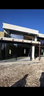

Hi all, thanks for the replies. This is what we have on site currently and having chatted it through with them today, he says that they basically go to the floor. The doc wraps underneath the insulation and up the wall and is painted with black bitumen paint, which is easily seen on sections where the wall covering will be stone on an Nvelop system.
The top coat goes over the grey liquid applied roof finish on the balcony area and then they have a different Atlas rendering product, he called it a mosaic, which is used at the base. He said this is a waterproof product that protects and acts to stop any water ingress. His view is that beed will do nothing. It is the water proof finish at the base that is important and that is the atlas mosaic product (which is white) or a tile where it is flush to floor.
At the front of the house (the second to last pic) where we have a raised area across the entire house, there will be a tile finish and a tile upstand.
The last pic shows the rear where the tile would be used like the front.

Base coat looks terible and the fixing pattern is wrong.
I got conflicting info on fixing pattern and process. Some said don't overlap at joins and fix points near centre. Others said to fix in the joins. Fill with expandable foam or render glue?
The fixing pattern does seem a little random. We were short on Ejot fixings and more are to go in. They are all glued/bonded also.
I saw that on the photo. To give the building a get out of jail card, the bottom pic was from my neighbours work that we did. It's the raised patio area wall. Not great but not structural and will be behind a cement render then tile finish. The top one is another garden wall that will be stone clad and cement rendered first.
And the blockwork with no gauge or apparently mortar at all? Good spot by Dollar
To which image are you referring?
If it's the white block, then they are glue bonded together. No mortar.
The grey ones and the white ones, almost any pic with brick or blocks in it. Proper glue bonding requires, or should require, careful cuts and precise placement and not using the bonding mix as a filler - as appears to have been done on that corner.
But it's done now and will probably be fine, with render over nobody wil ever know..except us
