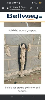

Plumber tapes all his pipes up that are touching cement then yellow gas on the gas pipe. Supposed to do it solid so the if it’s drilled through it comes out the hole and not fill the void.
Solid as in like this?
