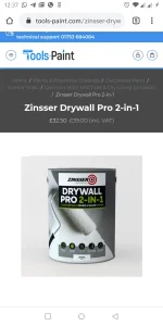

Will use this to seal the plaster
No worries , its a garage you'll be OK , just jibing at all that cost and effort not to go the extra bit for future possible use , Zinn is great product but I've once used garage floor paint on gypsum walls in a bathroom and shower , had no problems , price is a fraction
