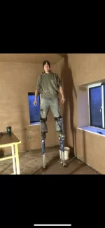

Reach 3m ceilings off my Skywalker 18-30
But I am a tall f**ker!
