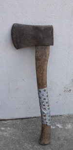

This not just gorilla tape with holes in it lol you can waterproof gorilla tape these days that sticks to anything an under water.
Yes, more or less.
it was based on gas plate tape which fixes galv sheet to brickwork, plaster etc.
The adhesive i use is similar.
The unique aspect though is the holes ,this allows plaster to key through onto substrate and also expels
all air, which means tape does not produce air pockets where it meets beads.
The surface is waterproof but matt finished with slightly mottled surface to further aid contact with plaster.
Basically though its tape with holes!
