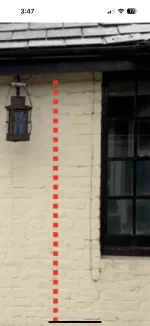

A picture of the exterior wall with the position of the internal wall. Internal wall butts up against the window at the right side of this picture
Exterior ground levels are low. Gutters have been checked. Loft area above is dry with no leaks. Weather seems to make no difference. It's there when it's sunny and dry outside as well as when raining. Before decorating I removed the wallpaper which shows signs of previous works on what I assume were to combat damp

Check your window outside, it has no cill that goes out past the brick work the drip under the wood part of your cill cannot work because someone has siliconed across the front and if they hadnt the water will just sit on your brickwork and find a way in extend the wooden cill past the brick work and make sure there is a drip underneath
Oh crap yes. Just looked at the brick pattern. Having said that I did find a cavity in the living room when I got heavy handed with knocking out a socket

Any holes where this cable is clipped/ enters building - water can track through.
Your brickwork looks like header/stretcher bond - solid wall, no cavity. What lime have you been using?
All clipped cables now removed and I had the plastic masonry paint removed to look for obvious cracks

I guess that external wall can’t breathe, paint on outside, tanking or something on inside going up nearly 2 meters. The internal adjoining wall also tanked (or whatever it is even just sbr) but only going up about 1 meter. the internal wall wicks the moisture out of the external wall or the ground (@Dollar lol) or both.
Is there a dpc?
then the heated room wicks the moisture out of the wall above the treated area on the internal wall as its the closest route for the water to get out into the air, as it is blocked everywhere else

Brilliant reply. Thanks so much. So I think I have removed what I can of rubbery exterior paint. There's no DPC. I was wondering whether to put in a physical DPC on the internal wall as it would be fairly easy to do behind the skirting. See if it dries out and then go in with the hacking off/lime plaster once resolved to get rid of salts
This is a holiday home/midlife crisis so it's not occupied a great deal meaning there's very little human created moisture most of the time. The heating is also rarely on and the wall is damp when we've been away for long periods
