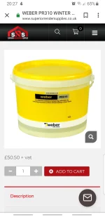

Sorry, last question, is this the primer to put over the old stuff?
Then apply new alpine finish over the lot?
Tia
Tia
I cant see it coz it only gives me the top half of the picture. But I think its 310?
I think its watered down sbr.
So would it be ok to clean, put sbr with cement mix on as a primer and put a coat of alpine over the top of that?
Oh and tes it is Weber 310...
So it was just a case of the rendergrip and alpine over the whole lot yeah?
If your still struggling/unsure? Get a local rep out from Weber or Parex or Fassa who can advise a complete system so your covered rather than a bit if this followed by bit of that etc. Any competent renderer should know how to sort your job out to be fair. Try googling some local ones and check out their work websites etc. Best of luck
Sbr 1:1 water or weber 310. Think it even said in a weber book you can use sbr as an alternative.
