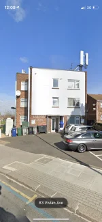

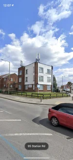

These are some photos of the block in question -

It says nothing about hacking off,how do you know its not solid and paint is dated and flaking?
Oh yea repair cracks ( I’m assuming in the render) . scaffold a few grand ,materials a couple grand ( I don’t do k rend so no idea of material prices) ! So yea maybe 10/12k 15 tops. But no way should that be gone over, it’s got to be hacked off
Stewie03
London prices fella although my advice get the old render hacked off on all 3 sides start from scratch and have it done properly and once it's done it's done you haven't got worry about it again unless you get cowboys doing it
