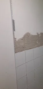

Brilliant
Proves my points
Plastic spacers replicate the tile size imperfection and the further you go up the more out of whack they get plus adhesive applied to the wall comes through the joints

Thats why I use ripped up cardboard from the tile boxes as spacers.
Also levelling systems with cheap large tiles and porcelain a must...some wickes cheap tiles are 2/3 mm different in size.
