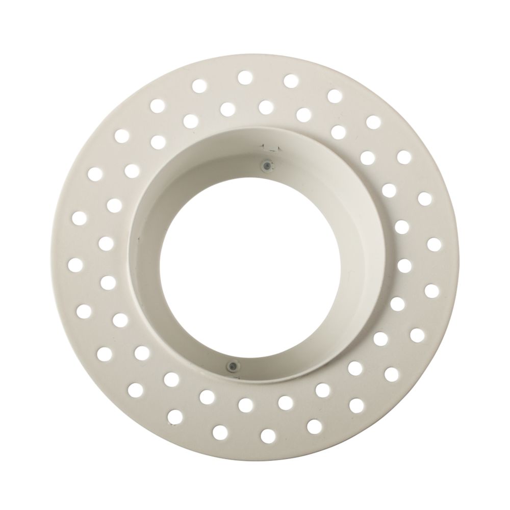

there is a new product on market
31867
staple that to ceiling.. skim then centre plate cuts out

I simply make it clear that if the sparks wants to make his life easier, and mine harder, it'll be costing them more.
However; getting on well with sparks on current job and offered to put those plasterspot things up if he marked out in time. They worked perfectly and he offered to pay for them he was so impressed.
