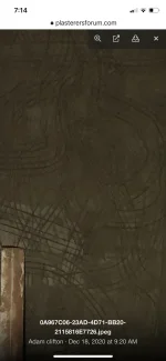

Good afternoon chaps I’ve just sand cemented a couple walls which had issues with damp , the customer put KA tanking slurry on a while ago , I scratch coated it yesterday & put top coat on today & rubbed it up . My question is what finish coat to put on it . A friend I know who’s an old school plastered very good to be fare said to me British gypsum guide lines recommend to leave it 28 days before applying finish coat . My mate prefers Thistle board finish over multi as it tends to shale if it doesn’t dry out completely . I was going back Monday to skim it . Any advice I’d be grateful. Thx in advance.

Only need to wait till the floating coats not green (damp) so that it’s contracted and shrunk, going on it while it’s shrinking will pull the skim with it and cause cracks everyone associates with solid walls, but it’s just not done properly often. Board finish is nicer imo, just need to control the suction to your need before skimming or you’ll have a hell of a time
Assuming that it's 10-11mm thick. Five days summer, seven days winter. If that's in a warm occupied house I'd give it five days.
The key is absolutely fine. I key sand and cement very lightly.

Haven’t done any float and set in years and that’s more key than I’ve ever given it with no problems ever, give it four or five days in a warm house it will b good to go I reckon

Too many bare bits without a key.and atleast me getting something wrong wont cost me my livelihood or home.just saying

Quick glance over in the evening over everything you’ve floated that day with a big trowel flattens any small bits.

What are you talking about you daft t**t? His key is fine. Misses aren't areas without a key, they're where the featheredge hasn't touched and the hollow not filled out.
Wow what's with daft t**t fatty? Figure 8 continously and you won't get bare patches all over shop..listen fatty stick to fishing
