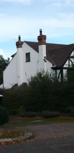

Keep on believing youd rather hand ball
Handball this gable my ritmo sprayed in 3 hours
True , am on the wind up a little bit , but have a serious point that for a solo doing jobs like in the video hardly seems worth the investment , traditional would be a lab and two to chuck on for anything bigger or two storeys ,
Yeah i was being lazy in that video to be fair. Id probably get the machine out for 8m2 though. Ha
