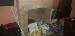

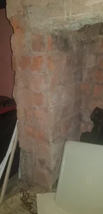

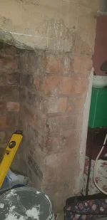

Total amateur here. I'm having a 5kw woodburner installed in our lounge later in the year. We took out an old open fire and opened the original 30s chimney breast.
I want to have a go at tidying up the chimney breast myself, but keep seeing conflicting information about plaster types/methods when looking on here and youtube videos.
My original plan was to cover the brickwork with SBR & cement slurry, then two coats of sand & cement render (scratched of course) . My neighbour who is a handyman said to skim with multi finish on top of that, but from doing research I'm now worried about heat resistance.
I'm planning on pointing and painting the brickwork in the chamber.
Also just thinking about the corners and uneven brickwork, would corner bead be OK on the chimney breast and stop bead around the chamber? What's the best way to make up the gaps? I'm aware I need to straighten out the lintel, gonna have a go with the grinder..
(excuse all the materials in the way in the photo, that's where I'm storing them for now)
Any advice Much appreciated, thanks guys!

Hi there I had a similar case like you, remove any loose blown plaster, PVA, dab a board to the whole front of the fireplace wall bead up then skim.
I cut back the edges and trimmed the bead to fit so you could see the brickwork. Here’s some photos hope this helps

wouldnt bother covering the entire house in dust with a grinder...
fix a render stop bead to the lintel... drill it 6mm, use red plugs and bang a 40mm galvanised nail in, chip a key into the concrete
heat isnt gonna be a problem, its on the face
fix a render corner bead to the corners same way keeping it straight and inline with the existing finish at the top..
stop bead the edge of the aperture, leave em 2mm proud of existing finish...
gob any big gaps out with sand and cement... let it go off for a day to stop it cracking due to thickness
render it in one coat using waterproofing additive (3 in one stuff) 2mm shy at the aperture
stick thincoat corner beads all the way to the top at the external corners...
skim it couple of days later making sure you kill the suction enough on the existing plaster
point up a bit behind stop bead in aperture
tricky bit really is using the render beads to trowel the finish up to so youll need to float the render a bit shy round the aperture and make sure the beads are a couple of mill proud of the existing finish
dunno how flat the rest of the breast is so guage youre bead positions based on that and use a bit of bonding if you have to
My advice around an open fire or log burner would be to reinstate and point the brick work or tile. The heat over time will eventually get at the plaster. Never dot & dab around a fire place, against fire regulations.

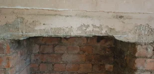

@Chris W - thanks so much for your detailed reply. Just a couple questions if I may..
With the lintel, are you suggesting I restore the profile with cement? The chunks missing are 40mm deep in spots so I'd worry it wouldn't hold? The woodburner guy needs to fit the plate to it I think. I've attached a better pic
The rest of the breast above the opening is pretty flat and the plaster seems mostly fine.

Render beads only to get your corner straight when you render it, theyll only be 2 or 3 foot, hieght of the exposed brick. Once its rendered you can stick full height plaster beads over the lot and that will give you a nice corner when its skimmed... Skim the cheeks (sides) too...
You could wedge a bit of timber tight up under the lintel and gob it up a bit before you fix a stop bead to the face, drill a couple of proud screws underneath in the hollows to grab it and make sure it stays put, take timber out when its gone off a day or 2 later and the plate will sit nice under it..
Tony rover seems concerned about heat on the face so if your worried make your render mix an 8:1:1 - 8 plastering sand, 1 lime, 1 cement... Should give it a tad more flexibility
