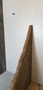

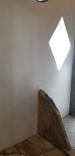

I'm late to the party but yes you can use plaster in a shower. It's all about the prep work. You water proof the area like you would for tile and then start your plaster process on top of that. I would look at Nova color walls2floor system as an option or Vasari Plaster has nice lime Plasters that can be used in showers with additives and sealers. Of the two I'd recommend Vasari because I think you have more options and I feel it looks better. That being said it is VERY different than pool plastering and may be a tough project if he isn't familiar with the product. I'm not saying it's rocket science or overly hard but there are a lot of steps and if you have a specific look you're going for I wouldn't have much confidence in someone being successful in their first attempt. Get some extra material and do a few practice boards to get comfortable.
Feel free to PM if you have more questions.
Pic is of a shower I finished a few weeks ago. There is a silver patina on the plaster that doesn't really come through but you get the idea.

That’s cool, like the piece of tree in the middle! Wonder where Rosie went!

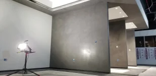

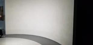

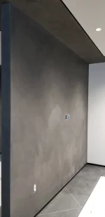

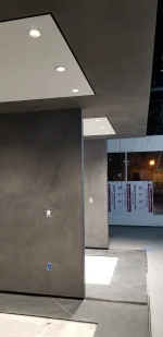

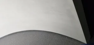

I have a few pictures of the last microcement project I worked on about a month ago. The white wall was about 20x12 and curved but I didn't get good pictures of it unfortunately.
