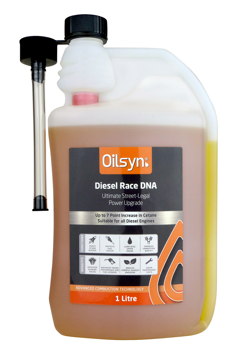

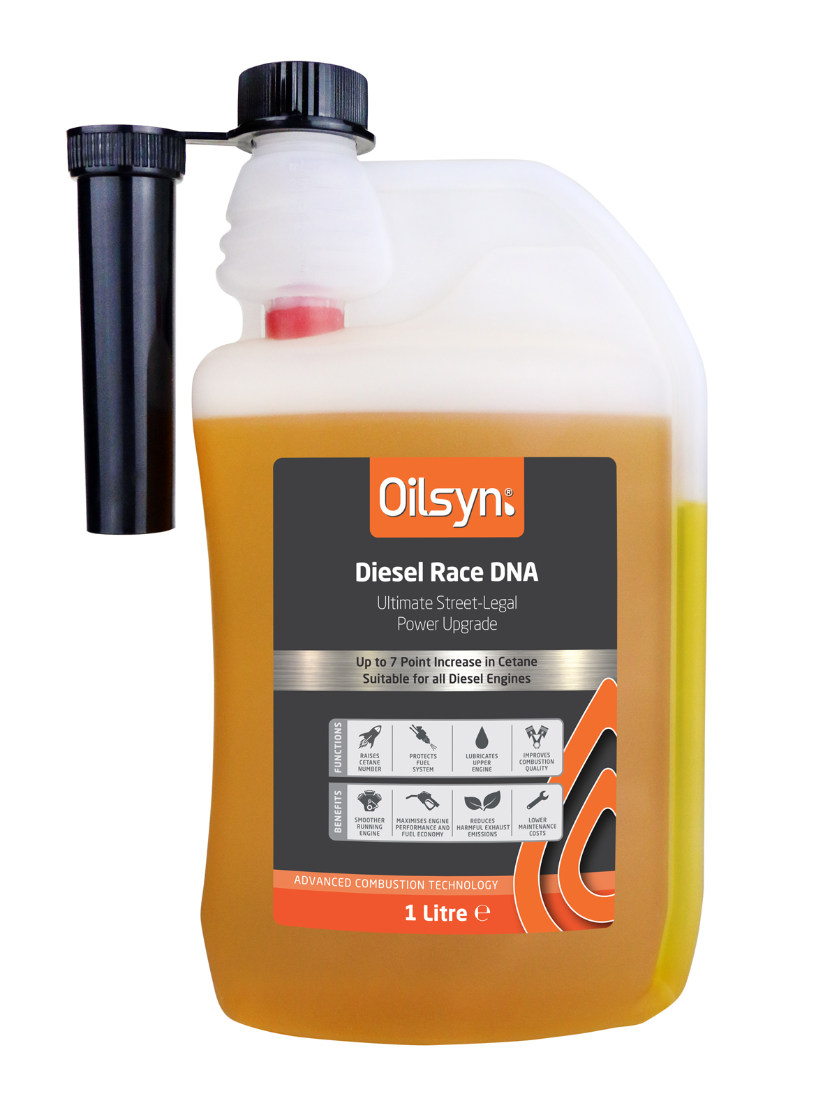

I Considered that malc. Will try keeping additives in the fuel to see if that helps. They help the soot burn off at lower temps apparently so it’s not so much of a struggle for the DPF.
