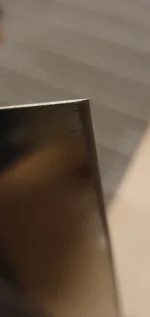

bobski
Is it a short shank?
Threw on with the 14" today, shank is ok and close to the front.
On arrival yesterday I thought it was too similar to the render trowel, it seems to have a tiny bit more flex though in use.
Felt really nice in the hand, with good balance. Metal is nice.

@bobski - looks decent. What’s happened to the corner? View attachment 55070
Just roughing
On my post #167 on this thread - the corners come way too sharp.
For both safety and to prevent "nibbing" where you just create far too many unnecessary lines, I roughed the corners off on a coarse slab. I do it to all my trowels then use them. After a while I refine the edge with way higher/smoother grits.

I'd do that with the toe but not the heel , I find it useful for pulling sharp corners

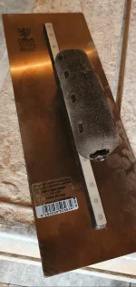

Understood,
And would usually agree, but they were razor mate.
This is of my other one I've not touched yet.

I usually use board and stand , went to grab trowel and sliced under my thumbnail , it's amazing h&s allow us to use them , imagine dropping one off scaffolding on site , 16" of razor onto some poor lad
