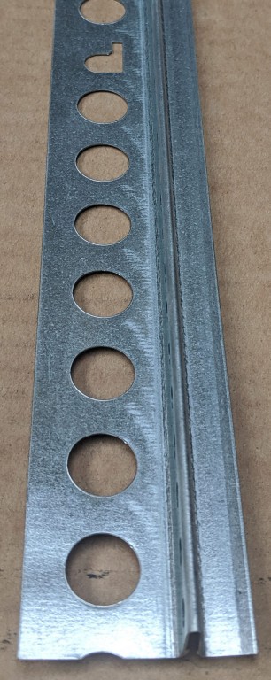

Just leave arci.s off
just use a stop bead or a shadow gap bead, i've done a couple of these over the years and always think traditional is best.
You would of been best with a door casing set up where you have 90deg return to it ....
Use 75mm door linings set in the middle of the block work. Angle bead around either side of the opening.
use shadow gap beads. weve done many of these.. google
shadow gap beads images and you will see plenty of examples.
i would pay extra for powder coated coloured though
You can also buy a door lining that is to be ‘plastered in’ its a metal frame with perforated edge around, board or float upto then skim over the edge for a seamless finish. We did some on some alteration work for a customer and they came out nice
Well that looks like the solution for the op. Apart from the fact they won't want to pay for them.
Hi Ryan, what product was used for this "plastered in" door frame please? Thanks.
