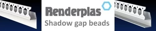

ps. I've put an image of our shadow gap profiles below, just in case you can use something like this:
Those beads you've shown Renderplas are for plasterboard and would be of no use whatsoever with S&C would they?
Almost like a plug for your company without any useful input to the thread.
Hi essexandy, that's right - they were attached as a 'just in case' as I mentioned, I didn't want to make the assumption that the render was being put straight onto a solid substrate. Believe me, we see some very odd specifications and get asked by architects, contractors and diy'ers to come up with solutions and interpret all sorts of diagrams and visions! My purpose here is to share and if possible cover all the bases.
