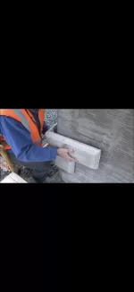

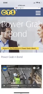

@stuart23 - CT1 is bulletproof, I’ve used it loads on exterior facade systems. The video shows the bloke fixing quoins.
  • Quoins
  • Quoins
