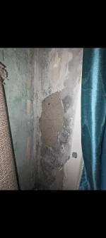

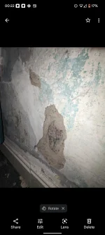

These are the bits I'm getting a spread in to sort properly. External walls around a window which it seems like previous owners have attempted to do something with unsuccessfully. The plasters blown and sand cement is just crumbling off to reveal brick. Im thinking penetrating damp from the old gutter & downpipe on the outside maybe at fault, which is being sorted.
I'm hoping they will take it back to brick but not sure if it needs lime plastering to keep breathability.. scratch float n finish.. or if other options would be more suitable

Insulate the external walls internally . you can then use modern plasters to finish. It’s not purist but you don’t have the budget
