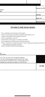

People often show pictures of wet plaster but it’s like showing a picture of a flooded front room but really pictures of the burst river banks are the ones that show where the problem originated rather than showing the symptoms. Put up some pictures of the roof from outside (ideally on a roofing forum maybees?)
Take roofing materials off
put back with inch gap but should be 50 mm min
£4300 lol
Don't think I've ever seen a 50mm gap on any set of plans mate. Felt is supposed to have a 25mm sag between rafters if I remember correctly?
On top of that architects can't add up. Nine times out of ten the speced insulation is as deep as the roof timbers, give or take.
If there's moisture getting in from above it's my guess that there isn't a membrane. Of course foil backed board is supposed to do away with the need for a membrane, but in practice is rarely doing the job.
