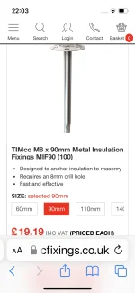

I’d put at least 6 fixings in per board. They aren’t expensive

BG ask for two fixings at mid height per full board.
They're not there to 'fix' the board, that's the job of the adhesive. They're there to stop the board falling on someone in the event of a fire.
They do, but they spec a frame type fixing which are s**t. I like these in conjunction with foam. You can use them to control the board as the foam goes off. If you’re careful you can dish the head in so it’s just below the surface.
