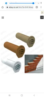

Are these ok. Be a night mate getting them other ones in
Not required end of
