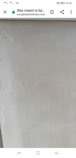

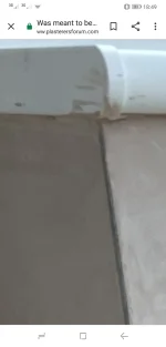

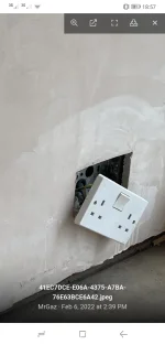

Hello. I joined to ask for the advice of the many experts on here, but got distracted by many of the hilarious threads and comments before actually doing what I was meant to.
Here’s my issue - we had the conservatory reroofed and walls plaster boarded and skimmed (by a professional - I’m not one of those visitors that has decided I can DIY what takes years to learn). The whole room is dry - we had rain last night and we now have these two wet patches in the corners. Anyone got any insight to let me know what is happening or what might need to be done to correct it as I’m guessing just banging a load of paint on won’t fix whatever the underlying issue might be.
Cheers

think i would look at the seals on the outside frames

Looks like water to me
One coat wonder !!

I'd say that's old lurpak at his tricks !!
That thin he's had to brush round the box stop it shelling off !! Lol

Unless the dabs are to close to the frame causing bridging. :D
Could be.... My bet is the last few days weather
Rain drives @ frame @ cill sealant is poor
Plasterer is not to blame for this one ... He only has complaint from customer on the finish of his work @ Not satisfactory...
