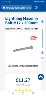

My mate has had insulation boards fitted and full house dry dashed. Question is he’s wanting to build a pergola coming from the house so he can sit under when it’s raining, question is, what type of fixing could he use to attach the timber to the back of the house? Obviously the insulation boards won’t hold much weight so have to go through the boards into brickwork.
Monkey Boy
These normally get me out of trouble
Different length thickness about but drill correct size holes and waz straight in no need for plugs and the like (hole in dashing way larger than the fixing)
