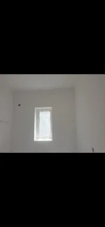

Just use the smet one coat HC projection plaster it will be the best way on your own
theclemo
