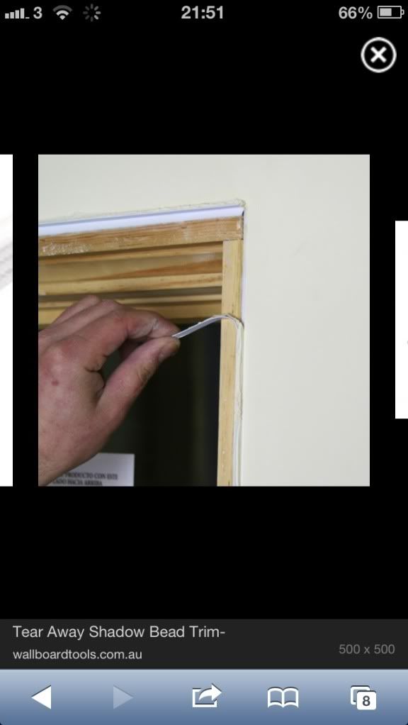

anybody got any pics cos av not got a scooby doo what ya on aboot...........:RpS_confused:
I just googled them as well arti and basically i think the architects like em cos they make the wall look like it's hovering above the floor if you know what i mean. :RpS_unsure:

round a door casing instead of arks
erm..........sort of.............:RpS_blink:
a shadow bead clips on a sheet of plasterboard before you fit the board,to give you you a finished edge.
we have used them to produce a gap around a door frame instead of an architrave, and above a skirting line to again to produce a gap. this was in a new hospital ,they then realized that it was a dust trap so we had to fill the lot in.
Not the same bead Malc,your on about the wrap around beads you can't clip shadow gap beads ( feature beads)
You can get shadow beads that clip onto board Superspread, not surprising really seeing as Malc has used them.
