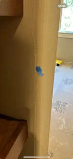

I recently moved into a house and had plaster work done with a sand-swirl finish. Much of the work was completed in a workman-ship like manner, specifically the field work. From my, unfamiliar with plaster perspective, I have some concerns the way the finer details were brought together. Is it customary for the bullnose details to resemble what is depicted in the photographs? I know this application is not as straight forward as drywall with a uniform finish. Thanks for the input. WB

I recently moved into a house and had plaster work done with a sand-swirl finish. Much of the work was completed in a workman-ship like manner, ((specifically the field work.)) From my, unfamiliar with plaster perspective, I have some concerns the way the finer details were brought together. Is it customary for the bullnose details to resemble what is depicted in the photographs? I know this application is not as straight forward as drywall with a uniform finish. Thanks for the input. WB
How do you mean ? "the field work" ?
It was only at the bullnose that looked bit odd to me. There appeared to be inconsistencies in the amount of texture or granular material relative to where there were filled in adjacent to the bullnose. As for the swirl-pattern throughout the space, it looks good. That is what I was referring to as 'the field'. So, you guys are of the opinion this is acceptable or unacceptable plaster work at the bullnose and adjacencies? Thanks for the input. WB
Were the bullnoses timber and he plastered up to them?
Bullnose corner bead is installed on 1/2" gypsum board that is attached to 2x framing members. Just a conventional wall (in the US) with a two-coat plaster veneer applied over the gypsum board. Thanks. WB
It looks like you’ve used a Veneer Basecoat to get the ‘sanded’ texture finish - this is difficult to get a decent finish up to a bead because of the aggregate in it.

Looks like they have coated corners and used a plastic bag to smooth off.It would of been a better finish to of used a brush and stippled it after to blend into wall.
