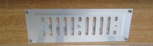

Yesterday I installed a couple of MAP vents in the kitchen baseboard and in the first floor boarding to try and help ventilation. I wasn't sure if I should put a brick one in the attic? Or will this aid condensation up there? We have got non breathable roofing felt but I guess its an old house so leaks anyways :X3:

  • Take the mesh out of the vents and make a proper bigger hole, it's doing nowt as it is. Then there will be a trickle of warm air up out of attic and helping to dry out condensation.

Only bit I already knew of it all was that them vents ain’t doing anything with a couple of poxy holes drilled behind them - Micky mouse effort those
