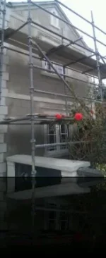

This one was a break from the norm, nearly 100 freehand quoins, with bands and ashlar markings ( scratchy head time.)

Nice work, would love to be able to do that. What kinda mix is used for that effect, is it a specialist stuff?
depends what effectt your after that one was using wallcrete, but we do em in sand/cement, and mono
If you have an artistic streak theres no limits to what can be achieved Paul. Like the vid. I have seen fake timber in earlier posts. Thats something we have done extensively on listed and historic buildings. The usual scenario is where the cost of splicing in small pieces of oak in non load bearing stuations is too much. We have carried out some superb timber fakings using hydraulic lime haired renders,with dies and kean artitsic eye.

that looks great mate do you stamp the render with a rubber stecil?same as patten paving,i want to do a limestone render course with these italian guys in perth when i get a break looks pretty close to what you do over there

Similar mate, but there seems to be a lot more scope with the gear we use, i don't want to go advertising the product, cos i would be treading on Danny's toe's , as he is in discussions with the company
here's another pic of render that we hand cut to look like brick and then tint to match the house brick, it's pretty dam close.
Before
After
