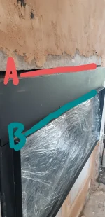

I'm have an in-the-wall electric fire installed in the chimney breast. I have my own guy that is going to board and skim the whole chimney breast once it's in situ. The shop-supplied fitters have knocked out the hole and wired the fire in, and they've left instructions for the plasterer to board up to the edge of the fire (line A on the attached photo) and then apply skim directly to the metal up to the window (line B). The fitters will then return to fit granite slips around the fire.

I think that both the fire fitter and the plasterer are talking about cross purposes.
The fire fitter wants the whole chimney breast stuck with plasterboard down to line B and skimmed.
The plasterer is talking about re skimming the original chimney breast which as he correct it will fail.
I would carry out the fire fitters instruction.

They both want to board, but the fitters only want him to board down to line A, flush with the front of the fire, and then bridge the gap and cover the distance to line B with the skim. I think it makes more sense to board down to B so the gaps are covered but the fitters are adament their way is best.

That's exactly what the fitters are asking the plasterer to do. Board to the edge of the fire, bridge the gap with scrim tape and skim the lot, board, scrim and metal, in one fell swoop. This is why the plasterer isn't happy.

dot / dab all front wall of fireplace to line B...... no adhesive on the metal is needed, if you dab all around the fire the 12.5mm p/board will carry without dab on the frame.........then skim it ...
if thats not good enough then the fire fittters arent getting there leg over because as a plasterer what more can we do...

Do as the fire fitters say they are the experts in this situation. It is not much different to skimming over a stop bead.
Couldn't disagree more with what you said a plasterer definitely knows more about plastering than a fire fitter and he's right you shouldn't skim over a smooth metal strip it's nothing like skimming over a stop bead they are designed to skim over
The plasterer is right to not want to skim onto smooth metal it a no in the plastering world

I wouldn't do it either why does the board need to stop at line A
Elite exteriors
I see now that it sticks out of the wall a bit so I'm guessing the board will finish flush with the edge of the fire the plasterer could run a scrim over the joint and skim to it but he's still right ask the fire fitters to stick to the metal and if they say it won't stick they're in the same boat as the plasterer it's their problem not his
Brimstone
Uh, Huh, Elite has spotted it, for some reason the fitters have not put the fire in deep enough, and are hoping the plaster can pull off hiding the fact that it's proud. A) They do not understand about plastering onto metal is a no no,
B) if they were honest and told him the problem, he might be able to hide it by dabbing all the boards out a bit further c) they can also cheat a bit with the tile addy thickness, unless there is a decorative frame with a fixed frame depth to go on over the tile edge.
