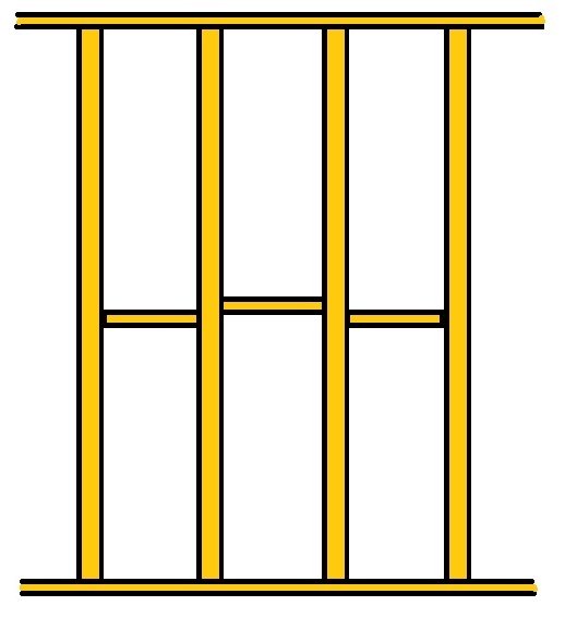

May I take a photo tomorrow, as there is no lecky there yet, only 1st fix. What we've done is basically (Perpendicular:RpS_wink:to the trusses) is measure from the first board to go down. Every other 600 middle support and outside edges.
Clearly do not know what I'm talking about, so would be so grateful if I could load a photo tomorrow as once you see it you'll either say 'uck a duck' that's cr@p or if I'm going to have a good day it may well be, 'Uck a duck, pluck it and make me a peking crispy, that is GOOD!'

As has just been said, work out how your boards are going to work across the the room squaring of your trusses not the walls then ping a chalk line down the the room for your noggins if the trusses are realy out you may find you have to plant some timber on them to pick the end of the boards up.we always cut boards into the wall cos something is normaly always out.

I'll load a photo and you can all have a laugh at my expense. I may have to go to 15mm after all!!:RpS_unsure:
Ah Ha! At least I put the screws in skew! I may looking at this actually have put in more noggins (Probably not in the right place!). But I think I got the perpendicular wrong........ I thought I'd be plasterboarding horizontally across the joist? so allowed my noggins that a way on.
I'll load a photo and hold the duck! I may actually not entirely stuffed it up:RpS_mellow:

Blimey, I didn't realise you needed a computer degree to upload photos, that's taken 15 noggins less!!
Here goes if I've got this right. - Roof space
Noggins
Not a very good diagram, but I'm no good with a camera either
Do I get my crispy duck?, or have I managed to make a right ducks ass of it?:RpS_blushing:
