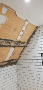

aGree, try it. If you put tile adhesive on first, you’ll be getting a good 4-5mm build after it’s skimmed which might not look good next to your tiles. I’ve used a bit of 6mm tile backer board over my central heating chases with a scratch of tile adhesive on, but going over with a float and skim coat.
