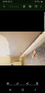

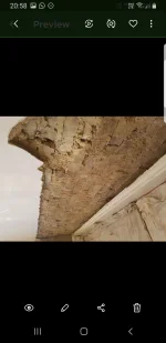

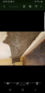

Hack off pal a good meter high..let it dry out then use limelight renovation plaster then skim using high impact finishing plaster,dont put any pva at all on the limelight if ur feathering in..only pva existing wall..limelight will sort it it will allow your wall to breathe..something along these lines
