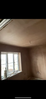

When done correctly no problem imo only on boards though
