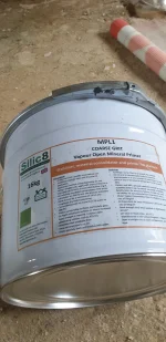

Any one tried this... I've give it a go and it's almost unusable to apply the lime putty over existing lime. This is what i was given to use..

I used it but onto the substrate before scratch cost, can’t say it did a deal
I'm trying to go over old existing lime with overskiming new lime putty. Paint that gear on day before, then still soak wall down after, coz that stuff not a sealer, hence still breathable, but still cannot control suction... finding it utter nightmare..lol.
Apply a lime wall finish on top of the dg27 that might solve your problem pal, horrible stuff to use mind
Yeah, give up the will to live yday with it... £175 a tin, too...
Took me hours to finish a wall, and was not happy with end result...got loads more to do....
