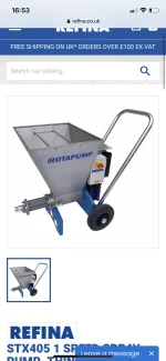

I’m looking for this machine to spray silicone or something similar that I can pour silicone in to. I have a compressor and hopper but I would like to use a hose instead.

im yet to find a machine that can spray and not leave it stippled and sharp
Don't think you'll ever find one buddy I use the eze 24 and Yeah it's a different look to padding it the machines just make bigger jobs so much easier and you don't have to worry about dry lines
