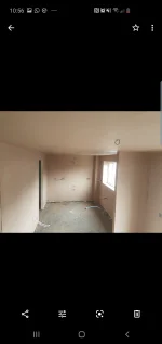

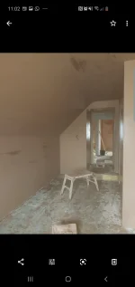

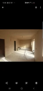

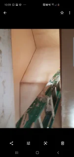

cold kicking in now.
skimming changed.
cant use flex towels the same.
get 18" glide it like a spat
I've started coating again with flex.
get loads on.
mt is scraping trowel now till spring![]()

I dont understand that1 bit pal no offence!
try 1 wall mate.
coat it neat with flex.
close it in
then bit of water glide the flex around it like a spat.
leave it for ages 2 cross towels youl be surprised how flat and flawless it dries![]()

I appreciate the guide mate but i still havent got a F*****g clue what your on about!!!!!
