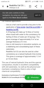

Sorry being out last night I talk s**t when I've had a drink. The bloke I did the lime course always said he was going to harle the walls for key.
Harling is a term used for finishing coat like rough casting but with lime
First coat is called harling for key in lime work. And term harling is finished product to
