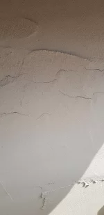

So ive been using this for the first time these last few weeks.
Lovely gear to spray and rule, and a c**t to rub up.
Been shown how to get the most out of it by the firm im on for.
Split like f**k today, top lift only
Why

What stuff you been spraying? K1 spray or K1 silicone? I take it you mean sagging between ribbons?? Only had it happen bad once that was because my r&s was done with. Straight on block or base and mesh?
Hpx on cement board fully meshed

If it’s the one loaded with silicone that’s why.
Silicone and water do not mix hence the splits, it’s the same with a normal rotar and stator it won’t go thorough and a clamped rotar and stator is needed to allow the material and water to be forced together.
If you manage to get it on the wall the silicone tries to repel the water and you end up with splits.
The way round it, I’m led to believe, is to really over work the material and rule several times making sure the material is pushed hard together.
I’m sure some swear by the stuff but we tend to stay away. Basecoats are decent but left a minute too late become sticky and unworkable
Just to add, I’d bet only the top has split due to is being in the shade therefor wetter for longer allowing the materials longer to try and seperate.
I’ve had the same problem spraying grey k rend, sprayed the front and side of a property on a damp overcast day and was riddled with splits, sprayed the back on a warmer sunnier day and went like a dream.
If we sprayed it again in the future I’d make sure the panel was in full sun, conditions were perfect, rule several times, serated spat it and then spat it flat. That’s a lot of work compared to other materials.

Next day dry base coat.
Its k1 not silicone
I used a serated edge followed by a feather edge then spat.
It was basecoated before the beads went on, to get the full 15mm. Maybe thats why, either way its a great looking material but takes f**k**g ages to work it and even longer to dry!

Silicone or not, that’s not the problem here, it’s the suction. When you do the mesh the day before the chances you get slumps like this are great. It happens with all manufacturers. The only solution here is to do the top coat in two passes.
And one of the biggest mistake here is to leave the basecoat flat and finish it with spat. It’s like trying to render over mirror
We've sprayed 2 pases on 7n block and still had issues.

It’s the suction tbh. Sometimes is better you don’t prime at all

Did you spray it mate and did you serrate it before levelling? Not a lot of body to HPX as its mostly adhesive so it goes on thin on CP board it'll slide if applied too thick and / or you trap air which doesn't get removed. Trapping air and then slipping tends to be a problem for the sprayers only if you don't serrate. Whats the reason for HPX anyway, HP12 may have been better depending on what you are doing?
