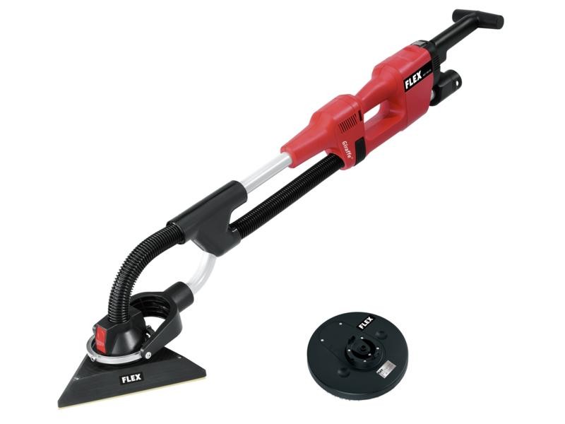

TonyM said:oasis said:i got the hand held M/T one but 220 grit is a bit fine dont ya think?
I had visions of you buying one of these
is it the hand sander with mesh sand paper? i've got one and used 120 grit and it just left lines so the finer the better i reckon,but try it out.oasis said:i got the hand held M/T one but 220 grit is a bit fine dont ya think?
ADS said:electric sander are great,without the vacuum connected i used be able to sand over 600m2 then seal it in a day.
i've been using lately with 60grit(seen this too on ebay very cheap whereas i paid over £40 for BG stuff) for taking the high points off artex before skimming.
Yep,a little bit.TonyM said:ADS said:electric sander are great,without the vacuum connected i used be able to sand over 600m2 then seal it in a day.
Are you (french word)ing mental? You must have looked like Casper the ghost at the end of the day.
