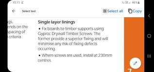

Actually I don't think there are too many screws. In fact there are clearly screws missing/too far from the edges.
@Donzo you seriously think that every 300mm on a ceiling is acceptable?
Yes,though some prefer 200mm spacing, it would do no harm with that amount of screws but think its overkill on standard 12.5mm. Depends on weight of board.the ceiling is lowered,he has framed it to his own spec.
I need to up my game,,,, joiner says spec is 150mm space on ceilings,more if boards are damp.200mm on walls.standard boards.
