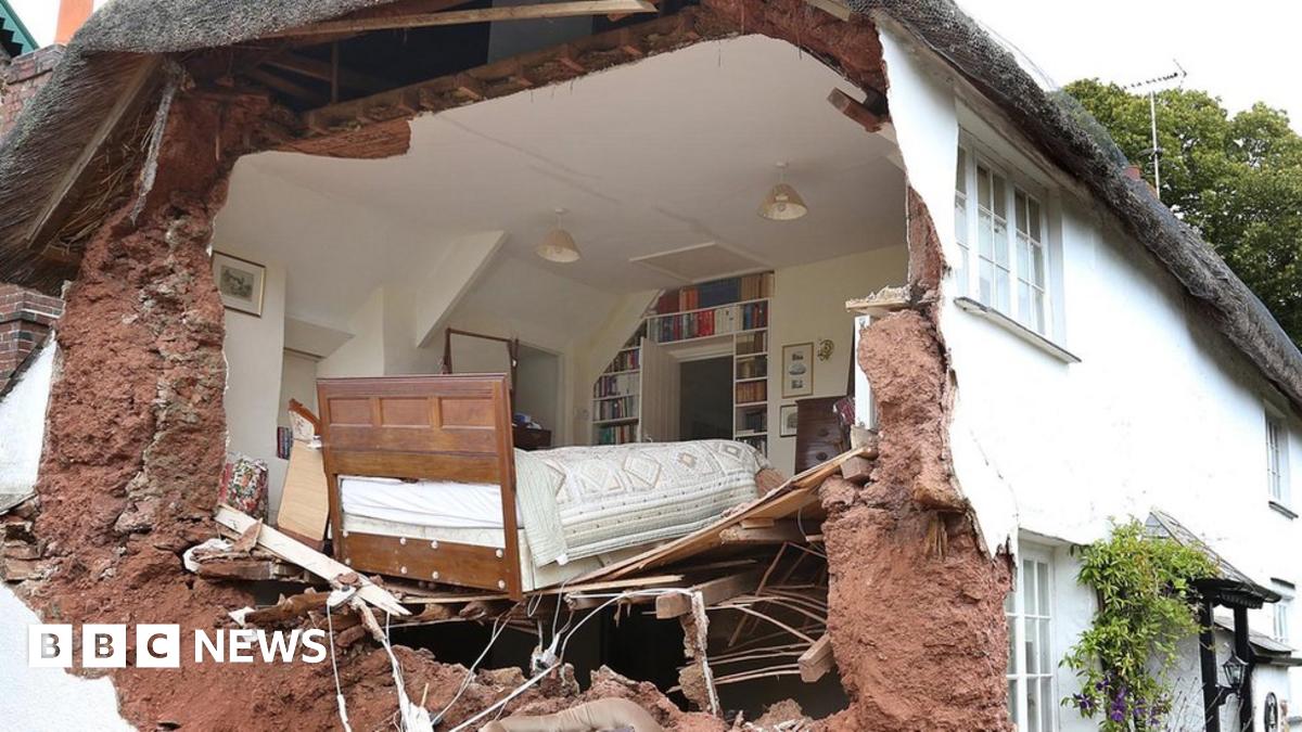

Please however protect our british heritage of cob houses though - these have been destroyed by inappropriate renders.
