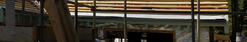

First I have to say ...I am NOT a Plasterer ....although i have "had a go" with bits of other trades ...I KNOW
when to get the pro's in .
I know this is a hello really ..but I thought i would take advantage and the reason I found this place.
We recently moved from the North to Milton Keynes ....and due to DAFT house prices here ...we decided to build on some land my wife family had ...sounds good...and it is...
So we chose a Potton house ...Timber frame ..its the basic package as we didn't have lots of cash to splash ...and trust me ...a year in EVERYTHING costs more when you are building a house ....but you guys probably know that already.
anyway its getting there ....roofers are in now and thoughts turn to the exterior finish ...Now my brickie is due to start in 2 weeks ...but being one of those "heritage" style buildings ...the top half is rendered (or similar)
Now when my dad was a builder (he is 94 now ..bless him) ...rendering meant slapping sand and cement on blockwork or common brick and occasionally chucking stones at it ...LOL. But I hear it has moved on :)
Now Potton recommend Stucanet and Sand and Cement Finish ...then paint. But almost ALL the guys I have had in for quotes are talking Self coloured Polymer whatsimadoobry ...
So I am looking for advice...and maybe someone in the Milton keynes area that might want a job :) ...In about 2 months
I do have some piccies ..so you can see where we are up to ...ew more roof tiles on since this taken a week ago though
Oh ...one of he chaps that came over to quote me a few weeks ago ...mentioned the "rafter feet" ....so i have added them ...apparently they can be a "arse-ache" to work around ...they are little bits of 4x2 that stick out and "pretend" that they are part of the roof ..its all for the look ...as you can see I have been at them with the paint ....its one job I am not half bad at !
I have been reading this forum for a few weeks before joining ...and I am figuring if you guys dont know about what i need ...then I may as well give up :)

Hi Mate..
im.not from your area but as a recommendation please do not use sand cement... it wont last...
timber moves sand cement doesnt.
personally i would recommend.the following.
25mm battens nailed.vertically to timber at 400 centres. this creates a cavity. with insect mesh top and bottom.
apply 12mm render carrierboard.(dont.butt the boards to.soffit. leave 20mm air flow gap for cavity.
then render with a thincoat silicone render such as jub krend weber which are available easily enough.
