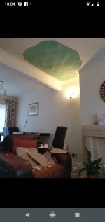

Just got a message to say a ceiling i did over 5 years ago failed...

I will sort for free but normally tell customers that skimming over artex is at their risk because i advise to overboard... But the cost of removing the coving and replacing normally puts them off...
I know the answer to this finish alone with no bonding applied to thick?
Also what's in the room bang above?
A bedroom pal, it may just be skim as it was before the invention of the zombie mix.... She is saying it was nearly 8yrs ago i did it ...
With how long ago it was i think it was thistle..... I only use the cementone/bostik one now....

Skimming over that shite theres always a risk of cracks or delaminating. Than fuk I dont do domestics no more
Had a wall shell off on blue grit once when it was painted a week later. Only time its happened. Put grit on way home on Friday afternoon, skimmed it the next day. Perhaps it hadn't properly dried, or possibly not stirred up well enough. Fair play for going back though (y)

The artex hasn't failed though has it?

Fair point - when I posted, I had it in mind that maybe the grit product had detached from the artex due to the artex surface unexpectedly not allowing the grit to bond properly, for some reason - i.e. if that happened, it would be out of control of the person doing the plastering (aside from overboarding it). If it was a kitchen rather than a lounge, my first thought would've been possible cooking grease on the ceiling.
Depending how big the room . A pack of coving cost about £30 max and will do an average room and will go up in an hour . Sometimes it’s just as cheap to pull cove off, board skim and cove again
It’s definitely the grit failing mate . Doubt that the manufacturer of the grit will compensate you though . It’s bad luck mate
