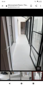

I rectified someone else's work and did this way and all was fine.Images are on other thread(microcement floors)
Fixing Faults in Microcement at Final FinishThis was applied with exeter
Client had crittel doors and due to them being close to rubbing floor there wasn't enough room to start again.It was only 11m2 but its fine and I did the 80m2 in property all good.
