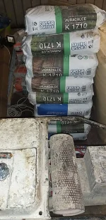

So
Whos used it ?
Ive sprayed it before, for dubbing out. Sprays well.
Ive been asked to price up a lime job, no dpc, had sand cement but fell off after 3 years.
Fassa say it can be i bared same as mono. Then floated. Would be easier than putty for sure.
Any one used it or similar bagged lime ?

yeah i used this on boundary wall on an estate. we sprayed day one and scraped it the next. did try sponging it but didnt like it.
topped it with s605 sponge finish
