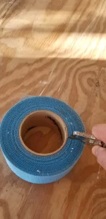

How do you mean 'cut the edge' mate?
A picture would do a much better job explaining it. Do a couple cuts on each side and you won't have to worry about it anymore. You're just trying to cut the last string or 2 on the outside edge. Even if it starts to pull off it'll only go about 4 inches and stop.
